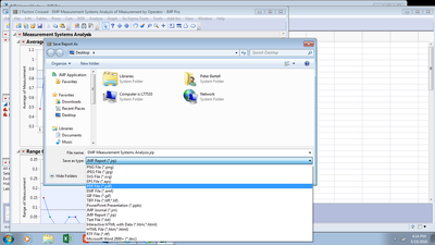

To add a bit to my colleague Ian's suggestion, if you are running JMP version 12, you can en masse export multiple platform report elements from the JMP analysis platform report window to your desired file format, select File -> Save As -> and then a desired file format. This will send all the major elements of the JMP report to that file format.

Please find an example:
NamesDefaultToHere(1);
biv = dt << Bivariate(X(:height), Y(:Weight));
myJRN = biv << Journal;
myJRN << SavePDF("$DESKTOP/My Journal.pdf");

Thanks, it was helpful
