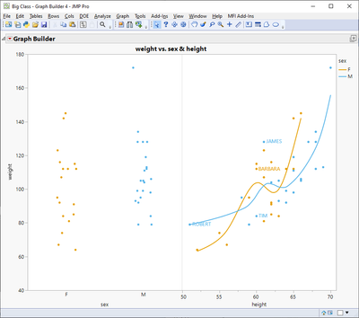

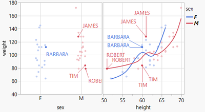

Is it possible to show labels just in one subplot, e.g. the right one, but not the left one?
... and just for a single points plot per Framebox?
Something like No Labels - forced! to deactivate the labels for plots where don't need them.
Names Default to Here(1);
gb = dt << Graph Builder(
	Variables( X( :sex ), X( :height ), Y( :weight ), Overlay( :sex ) ),
	Elements( Position( 1, 1 ), Points( X, Y, Legend( 3 ) ) ),
	Elements(
		Position( 2, 1 ),
		Points( X, Y, Legend( 4 ) ),
		Smoother( X, Y, Legend( 5 ) ),
		Points( X, Y, Legend( 9 ) )
Data Table( "Big Class" ) << Clear Select << Select Rows( Index( 6, 9 ) ) << Label;
// Unlabel column: name
Data Table( "Big Class" ):name << Label( 1 );

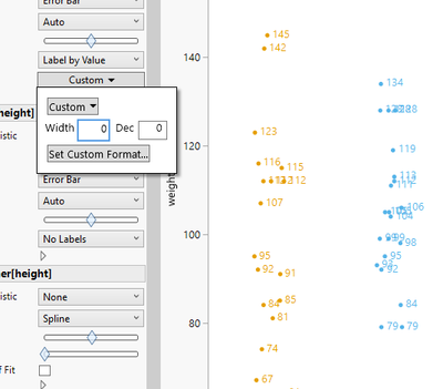

A workaround but you can use Label by Value and then customize the format (set width to 0)
If you need a script you won't won't directly get one (at least not with this method) and you have to make small modifications (I added 0 and -1 to label format)
Names Default To Here(1);
	Size(826, 660),
	Show Control Panel(0),
	Variables(X(:sex), X(:height), Y(:weight), Overlay(:sex)),
	Elements(Position(1, 1), Points(X, Y, Legend(3), Label("Label by Value"), Label Format("Custom", Formula(value), 0, -1))),
	Elements(Position(2, 1), Points(X, Y, Legend(4)), Smoother(X, Y, Legend(5)), Points(X, Y, Legend(9)))
dt << Select Rows(6 :: 9) << Label(1) << Clear Select;
dt:name << Label(1);

cool workaround : )
Label by value - which shows less than No Label.
Interesting that Advanced log doesn't accept the width=0 setting ?!?
