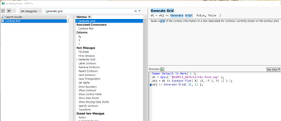

By any chance, do you happen to know the JSL for the grid generation?
I am trying to use table copy script, but it doesn't work.
For example,to generate a 21 horizontal grid, and a 32 vertical grid.

Here is the example taken directly from the Scripting Index
Names Default To Here( 1 );
dt = Open( "$SAMPLE_DATA/Little Pond.jmp" );
obj = dt << Contour Plot( X( :X, :Y ), Y( :Z ) );
obj << Generate Grid( 11, 11 );
Jim

Re: interpolate missing data value based on its neighbouring data
This is great, thanks
