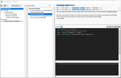

jthi
Re: How do I get a Newman-Keuls Connecting Letters Report without opening a OneWay analysis chart?
Scripting Index might give a good idea:
You might have to change the part of script where you use Make Combined Data Table, but JMP is most likely able to script it for you (do it manually and then get script from table script).
-Jarmo
