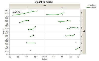

I would like to add an annotation to each individual frame of a graph builder report.  Here is a (trivial) example...
gb = Graph Builder( Variables( X( :height ), Y( :weight ), Group X( :sex ), Group Y( :age ) ) );
gb << SendToReport( Dispatch( {}, "Graph Builder", FrameBox, Add Text Annotation( Text( "Female-12" ), Filled( 0 ) ) ) );
In this example above, the top left Framebox has an annotation "Female-12" in it.    This was done in a hard coded way.  I would like to add an annotation to each Frame based on the grouping of data in that frame.
Ideally, I'd like to know what the X-group and Y-group is for each framebox and compose an annotation based on that and add it to each Framebox.
Ideally, I'd like to also redo these annotations after a change has been made to the local data filter in case the assignment of Framebox # to grouping changes as someone clicks through the local data filter.
So - how do I figure out which data is in each framebox?

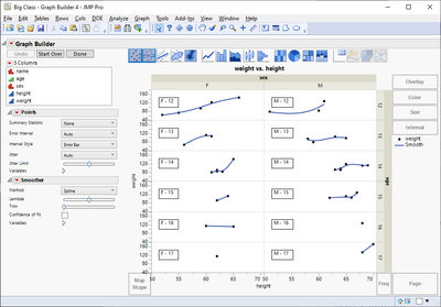

Groupings in graph builder are a bit annoying to work with, but... you should know the order based on the datatable and you also know the grouping columns you have. With that information you might be able to create the annotations
Names Default To Here(1);
gb = Graph Builder(Variables(X(:height), Y(:weight), Group X(:sex), Group Y(:age)));
Summarize(dt, uniq = By(:sex, :age));
For Each({{a, b}, idx}, Across(uniq[1], uniq[2]),
	frame = (gb << report)[FrameBox(idx)];
	frame << Add Text Annotation(Text(Eval Insert("^a^ - ^b^")));
With Local Data Filter you might have to parse the Where statement and use that information to get correct groups.

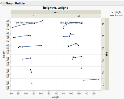

rgb[FrameBox( 1 )] << Add Text Annotation(
	Text( "Text for FrameBox(1)" ),
	Fixed Size( 0 ),
	Text Box( {-1, 5, 138, 32} ),
	Filled( 0 )
rgb[FrameBox( 7 )] << Add Text Annotation(
	Text( "Text for FrameBox(7)" ),
	Fixed Size( 0 ),
	Text Box( {-1, 0, 138, 27} ),
	Filled( 0 )
Jim

While your example shows how to add an annotation to each framebox,  the question I am asking is how to find out Y-grouping and X-grouping is in that framebox.
txnelson
Re: Custom Annotation Based on Framebox content
I do not know the answer to that.  I always have worked it by knowing what the X and Y groupings are and then going from there.  I suspect you could retrieve the script from the object, and then strip out the Group X and Group Y columns, and go from there.
Jim
