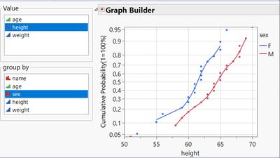

Re: how to make cumulative probability plots in JMP?
"remove variable" - just in front of my eyes, but I did not see it.
Many thanks

updates:
- remove & add variable (Y) deletes the normal probability setting on this axis
->  send the normal probability   command again
- new problem: when running the "transform column" a second time and more often, jmp adds a counter to the name on the y axis: Cumulative Probability[1=100%] XX -> Y axis no longer accessible by its original name
-> get the y axis title via xPath
- Excluded() added in the Col... functions to force jmp to ignore excluded() rows in the calculation.

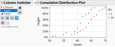

I just detected the Cumulative Percent entry in the Summary settings:
This way it gets very easy to generate a grouped CDF Plot - even with the possibility to use a column switcher:

Eval(
	Substitute(
			Expr(
				dt << Graph Builder(
					Show Control Panel( 0 ),
					Show Title( 0 ),
					Size( 500, 300 ),
					Variables( X( __col1__ ),
					Y( __col1__ ), // here is the error: use a column with "1"s instead to make it right
Overlay( __groupCol__ ) ), Elements( Points( X, Y, Summary Statistic( "Cumulative Percent" ) ) ), Column Switcher( __col1__, __myCols__ ), SendToReport( Dispatch( {}, "Graph Builder", OutlineBox, {Set Title( "Cumulative Distribution Plot" ), Image Export Display( Normal )} ) ) ) ), Expr( __col1__ ), Name Expr( col1 ), Expr( __myCols__ ), Name Expr( myCols ), Expr( __groupCol__ ), Name Expr( groupCol ), ) );

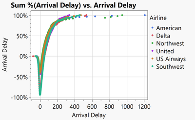

Ouch -  sorry, unfortunately, the code doesn't do what it should do.
Cumulative Percent sounded like Cumulative Probability [%] , but unfortunately, it doesn't sum ONES and divide by N, it sums the individual values and divides by the sum of all values:
If the values are "similar", it's a quick hack to get something similar to CDF, but e.g. if the values start from 0 - or are even negative, the plot differs significantly from a CDF.
So close - but too far to fix it, right?
dt = Open( "$SAMPLE_DATA/Airline Delays.jmp" );
	Variables( X( :Arrival Delay ), Y( :Arrival Delay ), Overlay( :Airline ) ),
	Elements(
		Points( X, Y, Legend( 6 ), Summary Statistic( "Cumulative Percent" ) )

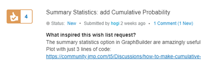

I posted a wish to add Cumulative Probability as an additional option for summary Statistics in Graph Builder:
Summary Statistics: add Cumulative Probability
So, perhaps in Jmp18 it will be THAT EASY to generate a grouped Cumulative Probability Plot in Graph Builder.
The huge advantage compared to https://community.jmp.com/t5/Discussions/how-to-make-cumulative-probability-plots-in-JMP/m-p/607570/... :It will be compatible with the Column Switcher Feature of Graph Builder. No need to generate a GUI around the plot.
