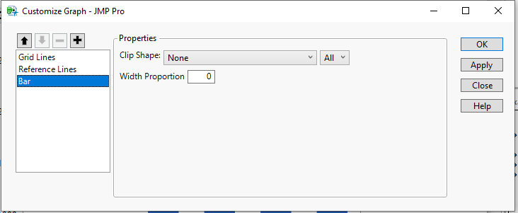

You can interactively change the segments, in the Customize selection when you right click on the graph, and there is no label segment.
