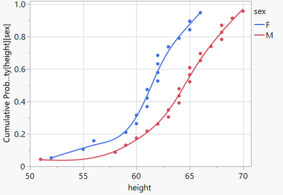

There is also a nice way via Graph Builder:

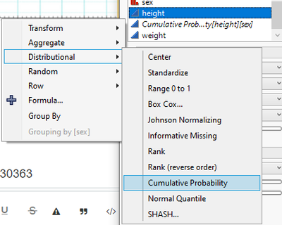

First select the grouping parameter
then use the (right click) context menu/Distributional/ cumulative probability function to  generate the ColRank/ColNumber equation and put it on the y axis (the value itself on the x axis).
that's it:
Open( "$SAMPLE_DATA/Big Class.jmp" );
Data Table( "Big Class" ) << Graph Builder(
	Size( 534, 464 ),
	Show Control Panel( 0 ),
	Variables(
		X( :height ),
		Y(
			Transform Column(
				"Cumulative Prob...ty[height][sex]",
				Formula(
					Col Rank( :height, :sex ) / (Col Number( :height, :sex ) + 1)
		Overlay( :sex )
	Elements( Points( X, Y, Legend( 11 ) ), Smoother( X, Y, Legend( 12 ) ) )

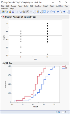

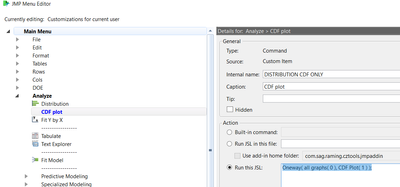

As I'm using this quite often, I've implemented a simple script in custom menue (view --> customize --> menues and toolbars),
running it with a table open it makes the CDF Plot quite easily.
Oneway( all graphs( 0 ), CDF Plot( 1 ) );
