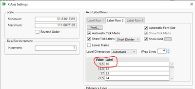

get values linked to axis labels
Hello, I have a control chart that has 3 different label rows on the X-axis. Is there a way in JSL to get the values that are associated with these labels? For example, for label row 2 I want to get the value that is corresponding with label "30", which is "5.5" in this case.
thanks!

I think the situation is still the same as here JSL Get 'Axis Label Row' Value of Labels -> there is no easy way of getting those. You can calculate them but depending on what you are doing it can be very easy/complicated.

That's unfortunate. The reason that I would like to get these values through JSL is because I want to add some code to the script that generates the control chart to have automatic updates of the X-axis. The control chart is a dynamic chart that gets populated with data on a daily basis and I would like the X-axis to automatically move forward as more data is being added, whilst keeping the same X-axis width (hence it would always show the most recent data for let's say the past 20 weeks). Are there any ideas how to do this? For now I only could come up with these values that I could use as variables.
jthi
Re: get values linked to axis labels
Which platform are you using for control charts (Control Chart Builder or Graph Builder)? Do you have more than one row of labels in your x-axis (in your screenshot you seem to have three label rows) and if you do, do all of them always have the same amount of labels?
-Jarmo
HannesJ
Level I
I am using the control chart builder platform and indeed have 3 label rows on the x-axis, but they don't have the same amount of labels.
Hi Jim, great tip.
I was able to set up a script that achieves what I wanted using a subset of the data as you suggested.
Thanks a lot!
