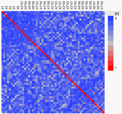

I thought I give a little follow up on the topic. I've created a custom design including main and quadratic effects for 9 factors. As I've said, there's a factor which is difficult to change (X1) and two factors (X2 and X3) are subject to a linear boundary condition (X2+X3 > const.).
This is the correlation matrix resulting from the custom designer:
The analysis after collecting the data showed that up to 6 out of 9 factors are active. It also happened that X2 itself isn't active but from physical considerations it should to be as its nature is the same as X3. Hence, I've tested for X2^2 and this is a significant contribution.
I hope my conclusion isn't jumping too far but it appears to me that the principles of sparsity and hierarchy are violated here.

I don't see the data table attached, so it is impossible to analyze the data.  How did the residuals look? Is there any collinearity between X2 and X2^2 (I notice X2 is not in your matrix?)?  Did you go too bold on the X2 level setting? Do they all have practical significance?  It is easy to have statistical significance, just minimize the factors that constitute the MSE.
The principles are just that.  They are not absolutes.  They are for guidance.  I will still suggest that 6 of all of the possible factors (much greater than the 9 you experimented on) is a small subset.
Recall F=MA...neither M or A are significant (both first order effects).

I hadn't attached the data table, only the screenshot of the correlation matrix of the experimental design. X2 is in the design. As JMP omits labels if the labeling becomes too dense, it's simply not labeled. X2 would be the second row or column, respectively. The design included the main effects as well as all quadratic effects. The correlation of X2 and X2^2 is 0.1.
The factors levels are reasonable based on our experience.
Overall, I'm wondering if the underlying physical model is more complex, over the given variable range, for being well fitted with a second order taylor polynomial (thinking of terms like radius of convergence etc. etc. - guess that would be a conversation for a conference and not so much for a forum discussion).
