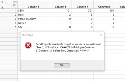

I ran the script against the subset sample data you provided, and it ran without error and produced an transposed data table. I did find one small issue, which was the Test Names did not contain the complete name from the input data table. But other than that, it seems to have run correctly.
Here is the corrected JSL
