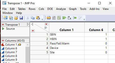

steo45
Level II
Re: JSL script to transpose columns to rows
there is no log error. when i run the script, it just doesnt do anything. the only difference is the test names... they are different. but all others headers are the same
txnelson
Try running the code for line 1 through line 26.  All you have to do, is to select(highlight) those rows in your script, and then click on the Run Icon.

See if the Transpose 1 data table looks like:
The run the lines 30 - 35
parameterColNamesList = {};
For( i = 1, i <= N Cols( dt ), i++,
	If( Is Missing( Num( Word( 1, Column( dt, i ) << get name, ":" ) ) ) == 0,
		Insert Into( parameterColNamesList, Column( dt, i ) << get name )
and see if the parameterColNamesList contains the names of all of the tests in the data table.
Then keep checking the different sections of code, until you find what is not running correctly.
If you can provide to me a copy of the data table you are trying to read in, I would be willing to do the checking myself.
