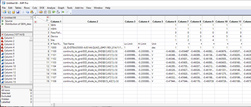

txnelson
Re: JSL script to transpose columns to rows
I ran the script against the subset sample data you provided, and it ran without error and produced an transposed data table.  I did find one small issue, which was the Test Names did not contain the complete name from the input data table.  But other than that, it seems to have run correctly.
Here is the corrected JSL

Jim
txnelson
This sample data table has an issue with the Device column.  It is set as a Character Data Type.  If you change it to Numeric, the script works fine.

txnelson
The error message that is displayed indicates that the data table that "dtTrans2" points to is not being created.  "dtTrans2" is created from a Transpose(), which requires a list of parameters from your original data table.  The "parameterColNamesList" is created by finding all columns in your original data table that starts with a number followed by a ":".  I suspect your parameters are not named like that in your original data table.  But without seeing the data table, I am only guessing.  If what I am guessing is true, then something needs to be found that identifies the parameter columns.
Jim

txnelson
The issue was that one or more of the Parameters were input as character data.  The Transpose can not handle mixed data.  So I have added a check to make sure that all detected parameters are numeric.
