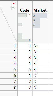

Hi, I have an input as below. How do I generate the summary output as below, using jmp existing function like tabulate or other, concatenating the market with delimiter "|"?
Once we have the output, how to use jmp function to convert the output back to the input format?
Thank you!
input
CodeMarket
1A
2A
3A
1B
5B
1C
7C
7A
output
CodeMarket
1A|B|C
2A
3A
5B
7A|C

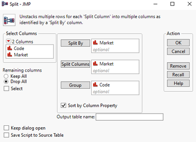

1. Tables / Split

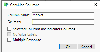

2. With A, B and C columns selected go to Cols / Utilities / Combine Columns(might want to keep Multiple Response, depending how you use the data)
3.  Delete unnecessary colums A, B, C

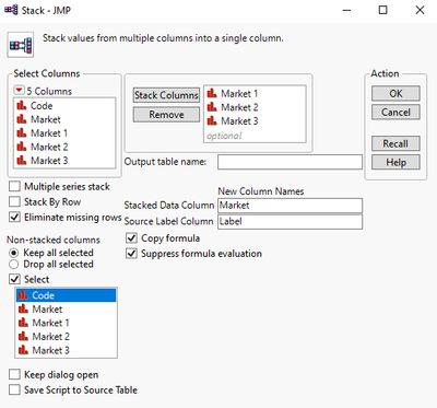

4. To go back, select Market column and go to Cols / Utilities / Text To Columns
5. Tables / Stack
6. Delete Label column
