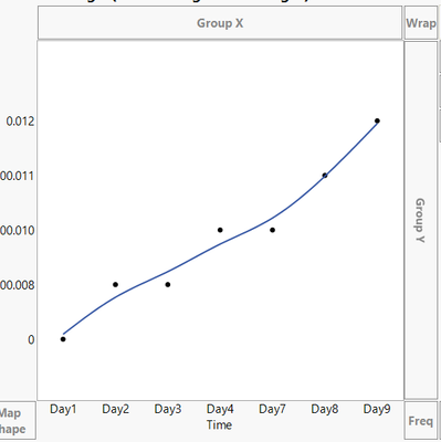

Day1
0
Day2
0.008
Day3
0.008
Day4
0.010
Day7
0.010
Day8
0.011
Day9
0.012

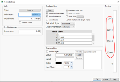

I want to plot a simple figure: Day vs Weight with Graph Builder. But the y axis looks incorrect. It uses my data value in axis, and I can't change it to, e.g. 0, 0.004, 0.008, 0.012...
My weight column is continuous. I just found out that I have value ordering in my column property. Once I removed it, the y axis became normal. Thank you for your help!
Your Time column appears to be a Character column, not a Numeric column. Go into the Col Info dialog and change the Data Type to Numeric, and the Modeling Type to Continuous
Check the Modeling Type on your weight column. I think you'll see that it's either Ordinal or Nominal. Change it to Continuous and the axis will be numeric and continuous also.
