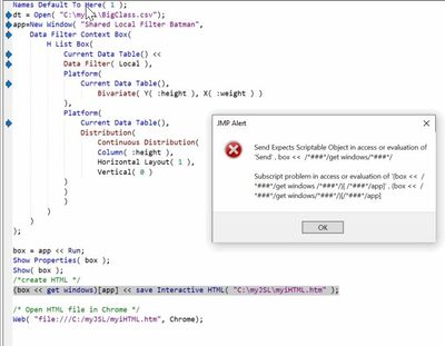

Need help. Got some error during create interactive HTML file
I'm writing script to make file HTML (interactive) by adding data filter feature into graphs but I got some error on the these following code during the calling function save Interactive HTML()
Thanks for helping on this.
The error message is below attached picture.
2022-10-28 11_24_49-Scripting Index - JMP.jpg2022-10-28 11_24_12-Shared Local Filter Batman - JMP.jpg
Here is my code
Names Default To Here( 1 );
dt = Open( "C:\myJSL\BigClass.csv");
app=New Window( "Shared Local Filter Batman",
	Data Filter Context Box(
		H List Box(
			Current Data Table() <<
			Data Filter( Local ),
			Platform(
				Current Data Table(),
					Bivariate( Y( :height ), X( :weight ) )
			Platform(
				Distribution(
					Continuous Distribution(
					Column( :height ),
					Horizontal Layout( 1 ),
					Vertical( 0 )
box = app << Run;
Show Properties( box );
Show( box );
/*create HTML */
(box << get windows)[app] << save Interactive HTML( "C:\myJSL\myiHTML.htm" );
/* Open HTML file in Chrome */
Web( "file:///C:/myJSL/myiHTML.htm", Chrome);

jthi
Re: Need help. Got some error during create interactive HTML file
I'm using JMP16.
I made slight modifications to your script. box variable isn't needed when New Window is being used like this (not sure when it would be needed, application/dashboard?) and you can just save the app (new window) as interactive html.
Names Default To Here(1);
app = New Window("Shared Local Filter Batman",
		H List Box(
			Current Data Table() << Data Filter(Local),
			Platform(Current Data Table(), Bivariate(Y(:height), X(:weight))),
			Platform(
				Distribution(Continuous Distribution(Column(:height), Horizontal Layout(1), Vertical(0)))
// box = app << Run;
// Show Properties(box);
// Show(box);
/*create HTML */
app << save Interactive HTML("$DOWNLOADS\myiHTML.html");
Web("$DOWNLOADS\myiHTML.html"); // open with default browser
-Jarmo

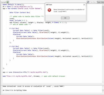

cpbatman
Level II
Hi John, @John_Powell_JMP    thank you so much that you forecast my next issue that I'm going to see it.
Now I got the problem that you told me hahha ^^"
Anyway, I try to added the code that you suggested (at comment zone added code to handle data filter), but I got some error as the attached picture. Could you please kindly help. Sorry for my interrupted, I quite new for JSL.
dt = Open("C:\myJSL\BigClass.csv");
		/** added code to handle data filter **/
		Local,
		Mode( Include( 0 ) ),
		Add Filter( columns( :height ), Display( :height, N Items( 6 ) ) );
		/** end of added code **/
		H List Box(
			Platform(
		H List Box(
			Platform(
app << save Interactive HTML("C:\myJSL\myiHTML.htm");
Web("file:///C:/myJSL/myiHTML.htm", Chrome); // open with default browser
Here is my error message.
Hi @cpbatman ,
You added the Mode and Add Filter lines to the Data Filter Context Box function rather than the Data Filter function. You also added an extra H List Box that duplicates the first.
Here's how it should look with some minor file name changes to make it work on my computer :
/* using sample data table */
dt = Open("$SAMPLE_DATA/Big Class.jmp"); // C:\myJSL\BigClass.csv");
		H List Box(
			Current Data Table() << Data Filter(Local,
			Platform(
		/** removed duplicate H List Box code **
		H List Box(
			Platform(
		** end of removed code **/
/* exported file location changed */
app << save Interactive HTML("$DOWNLOADS\myiHTML.htm");
Web("$DOWNLOADS/myiHTML.htm", Chrome); // open with default browser
Since you are new at JSL scripting, here are a couple of tips that should help:
1. Right click in the JSL editor and select 'Show line numbers' to help find the lines mentioned in the embedded log(below script).
2. To find out what parameters you can pass to a function, hover over the function name and a tip should show them. To get more information on the function, right click on the function and select  'Help Scripting Index'.
~John
