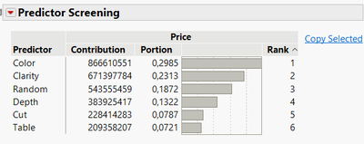

  • Since all factors are ranked, the threshold/limit between important and non-important factors is not trivial. To help you with, you can add a random factor (with random values). An example of this technique is shown here with the Diamonds Dataset from JMP with Price as response, adding a random factor and omitting Carat Weight as possible input (since it is a very important predictor, so I wanted to show you an example where it's hard to sort out the other predictors) :
