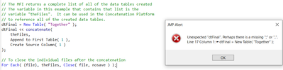

I have added the additional script lines, and I keep getting the error below when trying to run it, is JMP scripting case sensitive? I correct the "f" in dtfinal to dfFinal, but did not help.
txnelson
Re: import Multiple excel files with many tabs into one table in JMP
I suspect the JSL line just prior to the line
dtfinal = New Table( "Together" );
does not end in a semicolon.
Without seeing the lines before what you included only lets me guess as to the issue.
Jim

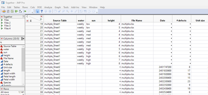

It doing mostly what is needed, only issue is that the added column that describes where the data point is coming from (the file and Tab) is not correct.
Ideally, I would like it to create a description column stating where each data point is coming file, something lie "File_Name_Tab_Name". Is there a way to add that to the script?

The script looks good, the generated file has a new column listing the source file name, but it is not listing the tab name. All the data from the three tabs have the same file name, nothing listed about the tab name. Any other recommendations?
Thanks a lot,
Faiz
txnelson
If the code you ran specified
<< Set Add File Name Column( 1 )<< import data;
The MFI will create a new column in each table created called "File Name".  It contains the name of the Excel workbook.  The MFI also gives each data table created a name based upon the  workbook name followed by the individual Tab name.
Therefore, when the Concatenate is run, with the option
Create Source Column( 1 )
specified, an additional column named "Source Table" is created in the concatenation result table.
and it contains the workbook name followed by the Tab name.  From what I interpreted from your question, that should provide you with the information you need.  If you want the data from the 2 column displayed in a different form, such as combined into a single column, all that you need to do is to create a new column with a formula that concatenates the information from the 2 columns together.
