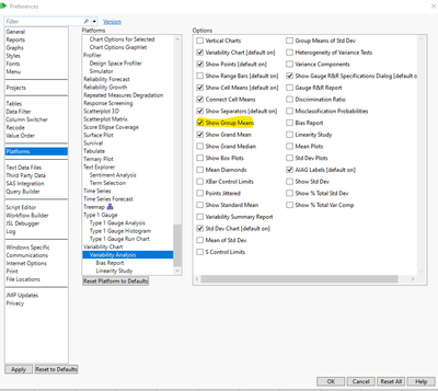

Does it help if you change the preferences in that platform? See yellow highlight below.
pauldeen
Level VI
Re: Variability chart misbehaving on JMP 17.1?
No change
