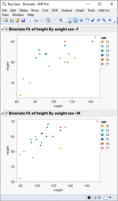

Adding legends to which plots? And using exactly which option? I assume you mean adding row legends to reports when using By columns?
If you mean this, it seems to work for me (but for some reason it didn't work on first time, maybe I wasn't holding ctrl down as I couldn't replicate that)

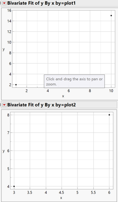

I use JMP pro 16 version and plot using "Fit Y by X"
I want to add "Row legend" to all my plot,
so, I press "control" button then click right mouse, and it work for all plots.
but I don't know when this (ctrl+right click) stopped working...

Yes, right-click and Row Legend work "without" using CTRL key.
you are right, row legend feature only work for single plot.
if I have 10 plots, each plot need add row legend, I have to do it 10 times.

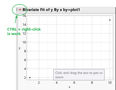

in fact, if I press and hold the CTRL key then click right-button, the menu can not pop-up.
without CTRL key then click right-button, menu can pop-up.
one interest thing is CTRL+right-click is work for red-down-triangle
(please see below green part)
