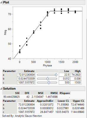

Hello everyone,
I have a problem with the Nonlinear Fit platform.
I am testing a broken line model on simulated data.
The model converged and I get a solution with Rsquare and estimates of the parameters.
I needed to have the confidence limits so I clicked on the confidence limits button.

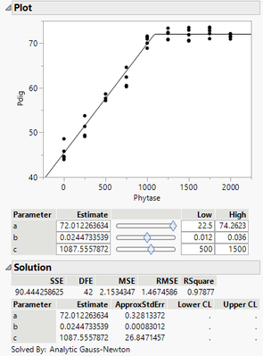

The confidence limits appeared in the parameters table but the Rsquare disappeared !
I could have the Rsquare back when I launched again the computations with the Go button but then the confidence limits were gone.
So I can have a nice report but I have to choose between Rsquare and CL. Of course I can export the results as tables but it is a bit frustrating though.
Is there a solution to this?

It looks like there was a bug here. Your post got sent to the development team, and i can confirm the behavior has been addressed in JMP 17. (JMP 17 will be released in the fall of 2022.) Thanks for reporting your issue here; these forums are watched and issues like this are often reported to the development team and fixed.

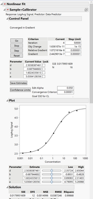

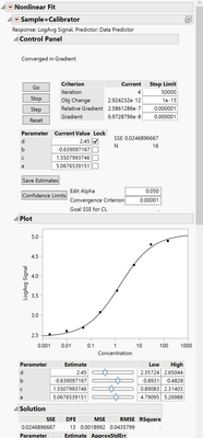

I too have a similar problem with JMP 18 using the nonlinear platform with an equation similar to the Rodbard 4PL equation, where if I choose to "Lock" one of the parameters (the lower asymptote in my case), then the RSquare disappears.
Can this also please be addressed?
