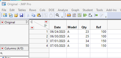

Re: Update table according to the date less than or equal to the reference file
Here is a script that works.  It will not be very efficient if the tables bet real large.
Given your 2 data tables the script will provide the update
Please note that row 4 has an update value, where your table did not have one.  Unless I am misinterpreting your requirement, the last row has a value in the reference table that meets te selection criteria
Names Default To Here( 1 );
New Table( "Original",
	Add Rows( 4 ),
	New Column( "Date",
		Format( "m/d/y", 10 ),
		Input Format( "m/d/y" ),
		Set Values( [3770409600, 3770928000, 3771014400, 3771360000] )
	New Column( "Model", Character( 16 ), Set Values( {"A", "A", "A", "A"} ) ),
	New Column( "Qty", Set Values( [23, 25, 34, 50] ) )
New Table( "Reference",
	Add Rows( 2 ),
	New Column( "Date",
		Numeric,
		"Continuous",
		Set Values( [3768422400, 3771014400] )
	New Column( "Model", Character( 16 ), Set Values( {"A", "A"} ) ),
	New Column( "Ref", Set Values( [100, 150] ) )
// This is the code that does the actual update
dtA = Data Table( "Original" );
dtB = Data Table( "Reference" );
dtA << New Column( "Ref" );
For Each( {row}, Index( 1, N Rows( dtA ) ),
	dtA:Ref[row] = dtB:ref[Max(
		dtB << get rows where( dtB:date <= dtA:date[row] )
Jim

UserID16644
Level V
Hi txnelson, it is prompting an error like this.
jthi
You are most likely running older JMP version than 16 (For Each was added in JMP16). You can fairly easily modify it and change it into For loop
-Jarmo
txnelson
I suspect that you have a version of JMP that does not support
For Each()
so if you change the For Each section to
For(row=1, row<= N Rows( dtA ), row++,
it should work.
Jim
