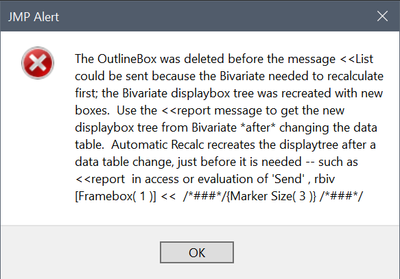

Hello! Been using JMP to create automation for data processing and reports.
One of my scripts is not working when I upgraded to JMP16. Already checked it on JMP15 and its not having this problem there.
The problem is the automatic recalc in several of my plot functions. It gives me this error message:
I already tried putting this line: "rbiv = biv << report;" before the marker size command line but its not working.
What has changed? Why was this ok in JMP15 and below versions and not in 16?

Feedback that I received from JMP was that, there are certain names (somewhere) in the codes built using JMP 15 not exists in JMP 16 (change name or something).
Maybe you want to consider to upgrade to JMP 17 before tweaking your scripts for another JMP version to avoid double frustration & also email jmp support.
