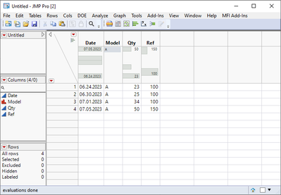

Here is a script that works. It will not be very efficient if the tables bet real large.
Given your 2 data tables the script will provide the update
![txnelson_0-1695961483960.png txnelson_0-1695961483960.png](https://community.jmp.com/t5/image/serverpage/image-id/57085iECA728728693FD20/image-size/medium?v=v2&px=400)
Please note that row 4 has an update value, where your table did not have one. Unless I am misinterpreting your requirement, the last row has a value in the reference table that meets te selection criteria
