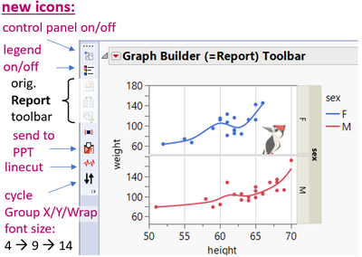

Alternative approach (if you need to rearrange the plots anyway in poerpoint)
With a shortcut on the Graph Builder toolbar you can "throw" graphs and reports to Powerpoint
... and Powerpoint will insert the graph/report in the current slide of the current presentation.
New version should be available within the next few days:
Graph Builder Toolbar
