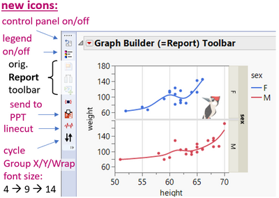

I added the windows version (via PowerShell) to the GraphBuilder toolbar:
Graph Builder Toolbar
