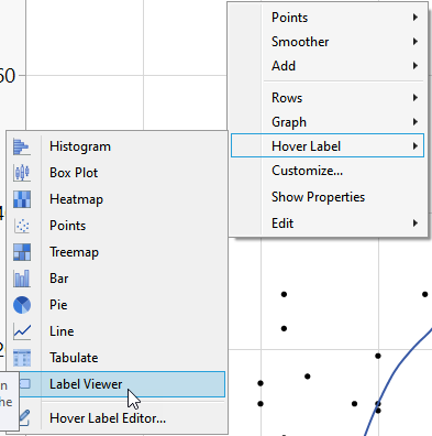

To see more labels at once, In Jmp >=16, you could also enable the Label Viewer from the Hover Label menu:
With Jmp <16 you can install the Label-Viewer AddIn and activate it from the Add-Ins Menu.

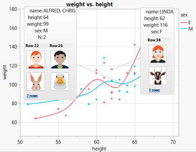

Hi @hogi , I'm trying to understand how the Label Viewer works. When I try it, I'm only seeing a single image, even when I have set multiple image columns to Label.
In your example, it appears the hover label is showing you two separate rows? And for each row, are the two images each saved in different columns?

Hm, surprising, @nascif_jmp ?
@markschwab , could you share your file?
In the Sample Library you can find an example file and a script to see how a Hover Label should look like with Label Viewer enabled.
dt = Open( "$SAMPLE_DATA/Big Class Families.jmp" );
dt <<Run Script("Display Multiple Images with Label Viewer")
