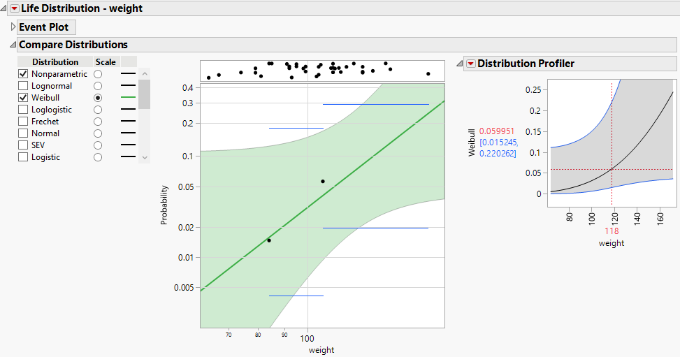

Here is an example. I used the :weight data column in the Big Class data table and pretended it was lifetime data. I added a Censor column with 1 in all but two rows, so only two exact lifetimes. I launched Life Distribution and selected the Weibull model and scale. You can use the distribution profiler to the right to estimate failure probability for a given time.

Thank you, this was incredibly helpful! Using the above, I was able to provide progression-free estimates at 1, 3 and 5 years using the Weibull model and scale.
