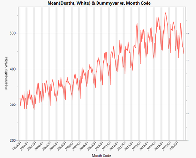

I think this is very close to what you want. I added a "Dummyvar" column to your data that is just a 1 for the holiday months, and empty otherwise. Then, I was able to create the graph entirely using the GUI (the secret was adding this dummyvar column, then moving it to the right axis and changing it to a bar chart, then adjusting that axis to make the bars go all the way to the top. Data table attached, with script saved to data table.

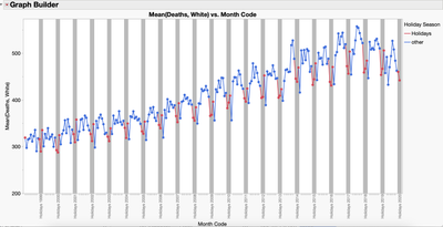

This type of shading was also used a few times to make the horizontal lanes in JMP Graph Builder Gant Charts easier to visualize and can be seen in this blog: Best of Pictures from the Gallery.

Excellent!  Just what I wanted.  Another example that answers are not as important a skill as questions (sure I wish I knew how to do it myself, but getting other people to solve the problem is almost as good).

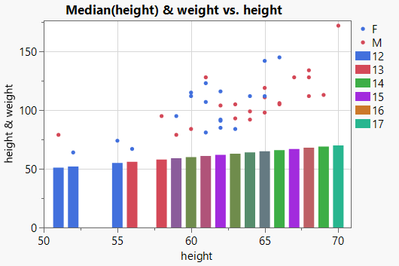

But wait, really? Let's try ...
This is amazing - multiple color settings possible for different plot types?
How could I miss this opportunity all the time !!!
Synergies:
https://community.jmp.com/t5/Discussions/Graph-Builder-subplot-with-different-color-settings/m-p/597...
Names Default to Here(1);
Graph Builder(
	Show Control Panel( 0 ),
	Variables(
		X( :height ),
		Y( :height ),
		Y( :weight, Position( 1 ) ),
		Color( :sex ),
		Color( :age )
	Elements(
		Points( X, Y( 2 ), Color( 1 ) ),
		Bar( X, Y( 1 ), Color( 2 ) )

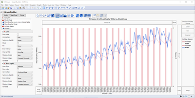

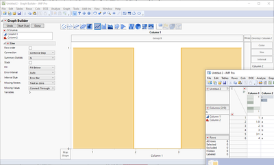

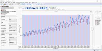

You can build graph like this with just Graph Builder, but it is a bit annoying.
I have created additional column (Column 5) with all values as 1. Then I have moved it to right side and and user Area chart for it. Key thing is to use "Treat as Zero" for Missing Factors (if you want to hide other regions from areas, set their transparency to 0).
You need to add Column 5 for script below to work
View more...
Graph Builder(
	Size(1141, 600),
	Variables(
		X(:Month Code),
		Y(:Column 5, Side("Right")),
		Y(:"Mean(Deaths, White)"n, Position(1)),
		Overlay(:Holiday Season)
	Elements(
		Line(X, Y(2), Legend(7)),
		Area(
			X,
			Y(1),
			Legend(6),
			Connection("Centered Step"),
			Summary Statistic("N"),
			Error Interval("None"),
			Missing Factors("Treat as Zero"),
			Missing Values("Connect Dashed")
	SendToReport(
		Dispatch(
			"400",
			ScaleBox,
			{Legend Model(
				6,
				Properties(0, {Transparency(0.3)}, Item ID("Holidays", 1)),
				Properties(1, {Transparency(0)}, Item ID("other", 1))
		Dispatch(
			"400",
			LegendBox,
			{Legend Position({7, [2, 3], 6, [0, 1, -3, -3]})}
There are also other ways of building something like this, here is a list of few of them

Another less elegant way of doing this is to use a pattern of axis range shading.  While pretty manual at first to set up (or script), it does give you nice labeling and other features that can make the shaded areas "pop" a little more to the views.  This can be set up though the axis setting GUI or through direct scripting in Graph Builder.  Attached my updated version of the data: CDC Axis Range Shading Data.jmp.
