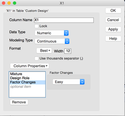

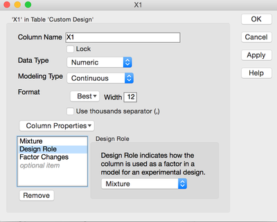

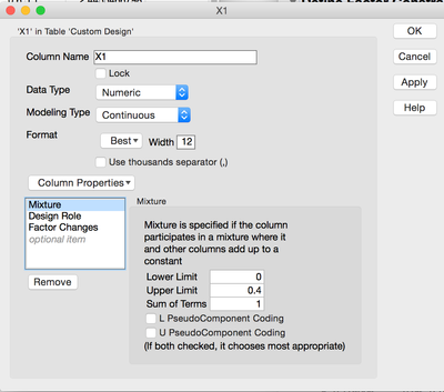

The metadata that I refer to is captured in the column info data. So for instance using your mixture example that you shared the three screen shots indicate the metadata that is captured in the column information. This is captured during the design setup phase. However if you just bring in data from an Excel file or another design package you would need to specify the metadata in the column info in order to have the correct coding etc.

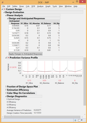

I think there may have been a misunderstanding, sorry for not being clear. Please allow me to clarify. I designed several DOE's using JMP and want to compare the result from the Design Evaluation menu:
Now,I've been taking screenshots and comparing them side-by-side to determine the best DOE. How can I save these results as a report? In table format would be okay, but it would also be nice to preserve the plots.

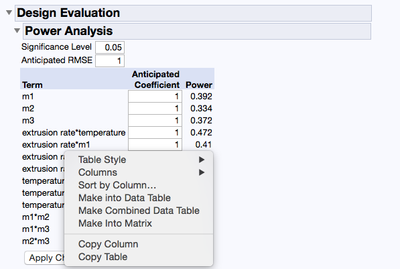

If you right click on any table you can make the numeric data into a table.
As far as saving the plots have you investigated capturing each design evaluation in a Journal. This would compile all of your output into one container.
