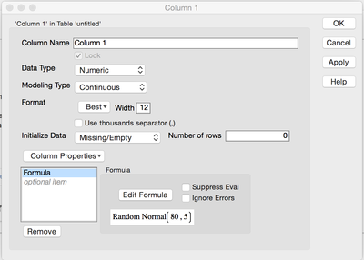

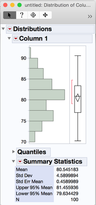

acid1c,
Will this do the trick for you?

Thank you for pointing me in this direction, but I found a better solution. Random Normal is generating numbers with a defined mean and standard deviation. A better choice is to use Random Uniform which generates numbers within a defined min and max range:
Right click on column > Formula > Random > Random Uniform > Random Uniform(min,max)
Re: Simulate responses within defined range
Random uniform does work well with a defined min and max, but it does not have a peaked shape like a normal distribution. If you want a peaked shape, use the Triangular distribution. It has a defined min and max with a mode or peak.
