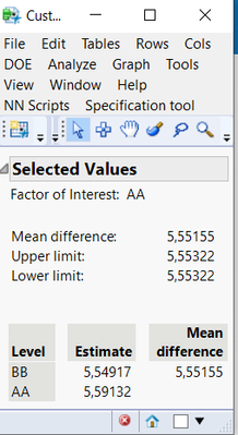

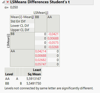

Hi all,
I am trying to make a report with specific data from the table of LSMeans Differences Student's t:
I would like a table with one of the formats as below:
Sadly, I cannot get it to print correctly for the mean and it cannot take data from the bigger table. I get the below
I have tried the following code, where I have altered the '17' to numbers from 1-30 and nothing works - 17 is for a different outline box:

tb << Set Shade Headings( 0 ); // Turn off shaded table headings.
tb << Set Heading Column Borders( 0 ); // Turn off table column borders.
How do you report the data from the bigger table?
