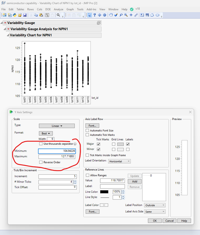

txnelson
Re: Get a question box to adjust y-axis (JMP v. 16)
My first response is "how is this different from just clicking on the Y axis for each displayed chart, selecting Axis Settings and typing in the min and max;

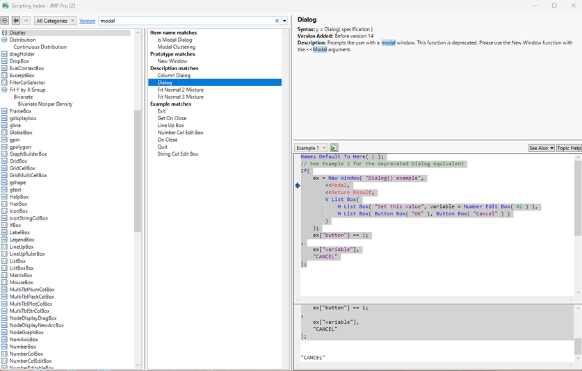

Secondly, if you want to pursue your suggested approach,  you will need to do some studying in the Scripting Guide to learn about creating a Modal Window that contains the Text Boxes and Number Edit or Text Edit boxes to input the users values.
Here is an example taken directly from the Scripting Index
     Help=>Scripting Index=>Modal=>Dialog
that provides an example of creating an input dialog window for user input.
Besides the Scripting Guide and the Scripting Index, there are a large number of Discussion Forum entries that you can search through to see how others have solved similar needs.
