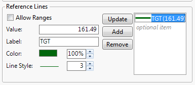

Hi All,
i am trying to use Label inside the graph instead of outside where it has replaced the number.
is there any way to do that. i dont want to add a text box which moves in both x and Y with scale change.
Thanks
Ram

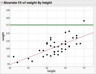

Re: Reference line Label inside the graph instead of outside
You can add any graphics or textual information you want to the graphical output from any platform.  All I did to generate the example below is that I ran the Fit Y by X platform, I then fit the line, and then added the reference line.....without a label.  Finally, I went to the toolbar and selected Text box.  I positioned it on the graph where I wanted it and then typed in the text I wanted.
Once the graph was the way I wanted it, I went to the red triangle==>Script==>Write Script to Script Window.  The script below is the script it generated.

This is just one way to do it.

Not a great solution but you could set the label to be "TGT = 161.5" and then you would have the label and a number on the outside of the graph.  I would like the option of setting the label to the "right" of side of the graphic (maybe the JMP elves can add that to their list) as I feel it often gets "lost" in the numeric scale.
Karen
Hi txnelson,
Thanks for reply. but this i already mentioned that this kind of test box changes position in graph with scale adjust (both X and Y).
it should only change position with only one axis change. e.g if it is a reference line for Y, then it should not change with X scale adjust.
