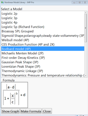

Re: 4PL fit (4 parameter logistic)
Hello,
I looked through the Nonlinear Model Library and I found the the 4P logistic model you describe is called the Rodbard Model (4P) in JMP.
Best,
Bill
Thanks a lot. Those are great answers.
