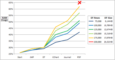

Yes, every machine is different (and running different background processes).  Based on my M's (machine, material/data, and method), JMP gets shut down (or freezes) when the machine approaches 65% RAM usage; this was using a data table of 200,000 rows (about 20,000 KB).  At this point, Windows Task Manager showed JMP memory usage at 1,343,424 KB.
Note that I was using these steps: (1) open JMP, (2) open DT & color rows, (3) run CChart, (4) create Journal, and (5) save as PDF.
Any help with interpreting data table file sizes (converting from KB to GB) for JMP memory management would be appreciated. Thanks!.

I aggree with all the others regarding RAM, data size and the other things. In Addition you should consider, looking at the RAM usage, that for the Export to PDF the System will start Acrobat Reader or the apropriate PDF program you are using. This will increase the RAM as you could see in your graph. Depending on the way you save the report in the journal (with data table in place or just the script to generate the Report with a reference to the data table) you will use more or less Memory and the file size of the Journal will be larger or smaller. And as a consequence the PDF file size will also adjust (simply due to the fact of the picture vs. line with a script - but I guess you like to have the graphics in the PDF as well and not just a script line).
That said, there is a lot of overhead independent from the actual file size you must not Forget to consider when calculating RAM to be used.
May it also helps if you may be able to close data tables and reports immediately after you do not Need them anymore, e.g. after saving to the Journal and before saving to PDF. I think worth a try. As well changing your System Settings (if you are on Windows) to allow for 3GB RAM usage even on 32bit Systems. You'll find many guides on how to do that step by step for your System in the web.

After I created my journal, I closed the data table and analysis. This did free up 16% of my working memory for creating the PDF.  And I was able to successfully create the PDF.
I will also look into the other methods suggested by you and others.  Sounds like there are a lot of variables that contribute to this.
