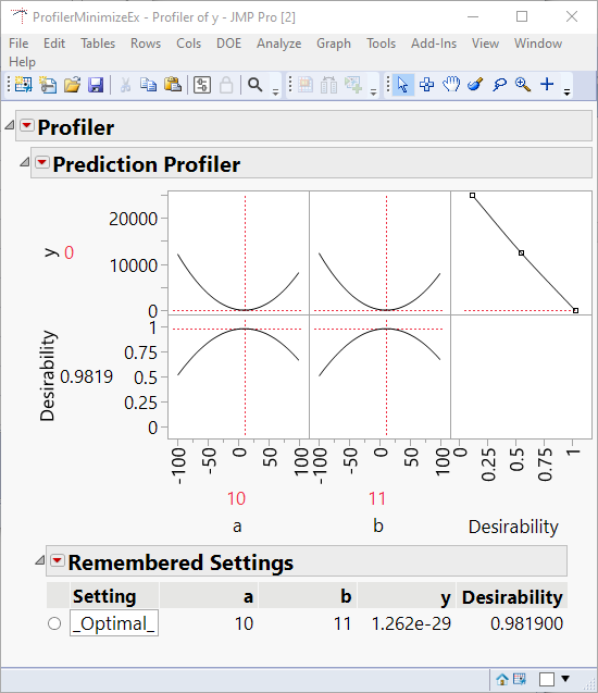

Re: Problem with minimize function in JSL
It's hard to say exactly what is happening without the ability to run the example myself, but there are two other approaches that come to mind that you could possibly try.  The first is to use the constrained minimize function without any linear constraints.  It uses a different method than the minimize function, so it might possibly help. So, from Craige's example you could do something like the following:
aa = expr(
	Show( "evaluating", Char( a, 19, 16 ), Char( b, 19, 16 ) ); // peek inside
	(a - 10) ^ 2 + (b - 11) ^ 2 // the function, roots at 10 and 11
min_test = Expr( Eval( aa ) );
minFun =
Constrained Minimize(
	min_test,
	{a( -100, 100 ), b( -100, 100 )},
	<<StartingValues( [0, 0] ), <<show details(true)
Eval List( {a, b, minFun} );
Or another approach you could try is to create a small data table and use the profiler to do the optimization.  I'm not really sure how well that will work with your formula, but I am attaching an example of how that would work with Craige's example. Here is a picture of the solution you get if you optimize the function in the profiler:
If you run the first script attached to the data table, you will launch the profiler before optimization.  The second script launches the profiler with the optimal solution. The profiler uses multiple random starts, so it is more robust for finding the global optimal solution.
