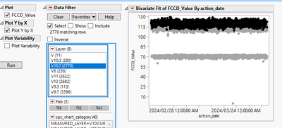

I am trying to build a dash board that will plot relevant graphs.
My current issue is that it plots the entire data on one graph, highlights the filtered data and the rest is grayed out.
I want to graph to be build only with the data of the relevant rows of the given column.
For example, if I want to plot height as a function of age, and I have a column for "sex" which holds 'M' and 'F', so I have the filtering option
for "sex", if I choose 'F', the 'M' data will be grayed out. I want the chart to only show the 'F' data.
How do I do that?
Thanks,

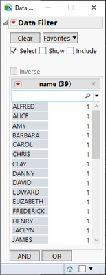

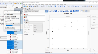

Change the filter settings (enable Include / Show depending on your use case)
Edit:
This explains the different modes https://www.jmp.com/support/help/en/17.2/#page/jmp/filtering-modes.shtml#ww609720 (select isn't available for local data filter)

Thanks for the reply folks,
But I'm looking for a JSL code lines to do that, not by the options I have in a graph.
To better explain myself, my code gives the user the choosing options shown below.
When the user chooses V10.7 it highlights the relevant rows under column "Layer".
I want the graph to be shown only after the user chose the layer, and show only the chosen data.

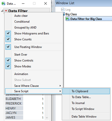

Do it first by hand and then get the script
add show
go to red triangle menu and save script
Current Data Table() << Data Filter(
	Location({1104, 309}),
	Mode(Show(1)),
	Add Filter(columns(:name), Display(:name, N Items(15), Find(Set Text(""))))

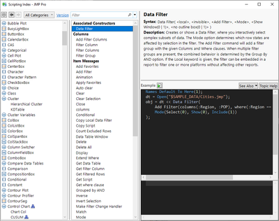

You can also go and check Data Filter from scripting index
and from there you easily get to documentation by pressing Help https://www.jmp.com/support/help/en/17.2/#page/jmp/data-table-messages.shtml?os=win&source=applicati... and https://www.jmp.com/support/help/en/17.2/#page/jmp/add-a-data-filter.shtml#ww795815
