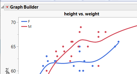

That is the setting that I want to override.  I don't want Left or Right I would like to be able to fine tune the "Horizontal" position of the "Legend" or at least do a " Legend Position ("Inside Center").  In the code that you posted the Legend is still on the left (see pic). Sorry if I was not clear about what I trying to do.

The documentation in the Scripting Index indicate that only 4 options are available
