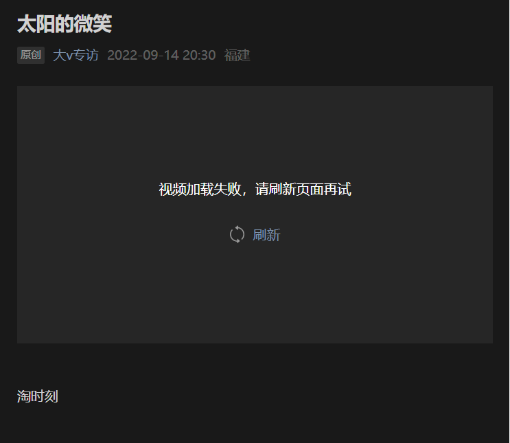

Open an html file with JMP's built-in browser. How do I get the content displayed with JSL?

太阳的微笑
原创 大v专访 2022-09-14 20:30 福建
淘时刻
人划线

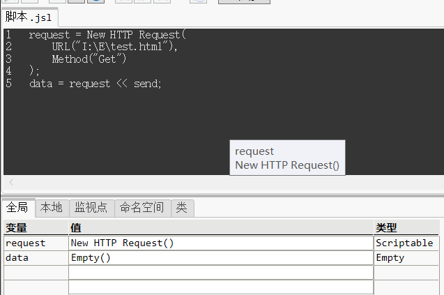

jthi
Re: Open an html file with JMP's built-in browser. How do I get the content displayed with JSL?
Use New HTTP Request with Get method on the URL
request = New HTTP Request(
	URL("https://www.jmp.com/en_fi/home.html"),
	Method("Get")
data = request << send;
You might also have REST API endpoint you could use. If these aren't enough might have to use something like SeleniumBrowser Scripting with Python Selenium
-Jarmo
lala
Level IX
This is the only result:

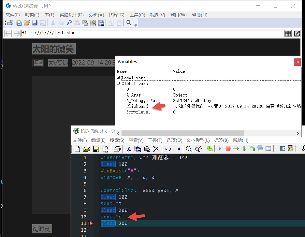

lala
Level IX
Call AutoHotkey with JSL to copy.
