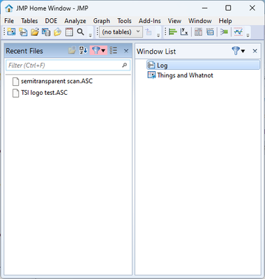

Re: Private Tables from SQL Query << Run Background, New Data View, table list not updating?
Actually, after my queries, the now visible data table does not show up in the data table list combo box at all.  The table is there in the Window List, but the box says "(no tables)."  Peculiar.
Current Data Table() gives an Empty() value, unless run inside a table script, which correctly yields Data Table( "Things and Whatnot").  However, even inside that table script, an attempt to reference Data Table( "Things and Whatnot") throws an error: "Cannot locate data table...."  It's interesting behavior, and I'd like to understand why it occurs under these specific circumstances.
