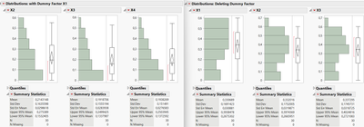

When comparing the distributions of mixture factors with the two methods :
We can see that keeping a dummy factor tends to bias the distributions of other factors towards lower values, whereas deleting the dummy factor and creating the design while keeping the high limits (or simply enter the high limits at the beginning) enable to have a better repartition of the points.
This is also visible with the "discrepancy" values of the two designs (around 1,8 when deleting the dummy factor or with the high limits setting against 3,2 when dummy factor is kept) which also shows that deleting the dummy factor (or directly entering high limits) provides a relatively better design (lower discrepancy is better when comparing two space-filling design).
