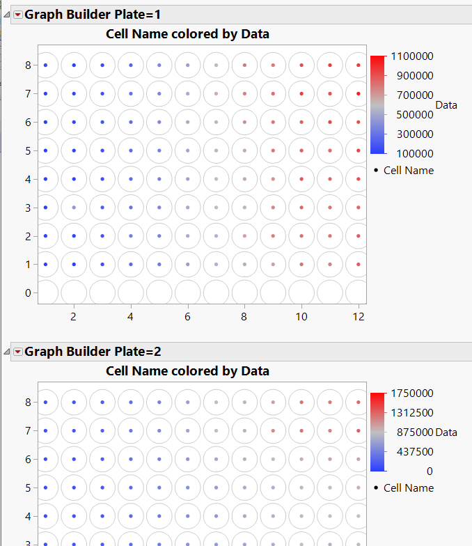

Hi,
A previous post touched on this topic: https://community.jmp.com/t5/Discussions/Repeat-legend-with-every-page/td-p/47575
However, I tried using the hidden "By" variable in Graph Builder using well-plate data but I wasn't happy with the way it looked (see image below):
Somehow, the wells weren't filled-in anymore.  However, I was able to get there by dragging my Cell Name column into Map Shape, my data column into Color, and then saving the script to a script window and manually adding the By variable (see below).
Graph Builder(
	Variables( Color( :Data ), Shape( :Cell Name ) ),
	Elements( Map Shapes( Legend( 3 ) ) ),
	By( :Plate )
Please try that out and see if it works for you.

Hi,
Graph Builder(
	By( :Plate )

Hi,
The original solution will fill in the bubbles if you select map shapes in the options drop downs.
Thank you for this information and the work around if I can't get it to work with the shapes some time, this helped me tremendously.
