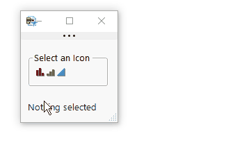

Yep, MouseBox can do all of that. Mouseboxes can also hold data for you to use in a callback function. Below is a small example of using icons as buttons, but you could also use pictures.

New Window( "Example",
	V List Box(
		Panel Box( "Select an Icon",
			H List Box(
				Icon Mouse Box( "Nominal", ["type" => "nominal", "someOtherData" => 1] ),
				Icon Mouse Box( "Ordinal", ["type" => "ordinal", "someOtherData" => 2] ),
				Icon Mouse Box( "Continuous", ["type" => "continuous", "someOtherData" => 3] )
		Text Box(), //Spacing
		txt = Text Box( "Nothing selected" ),
		<<Padding( {10, 10, 10, 10} )
Here's an aimated GIF of the above script in action:
