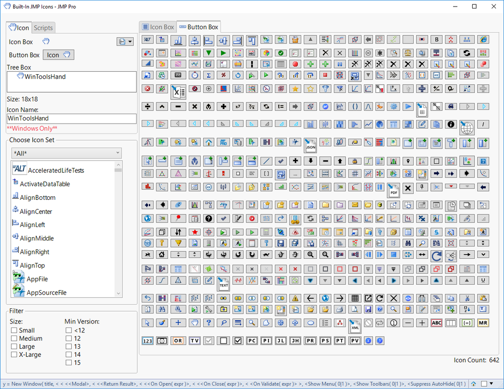

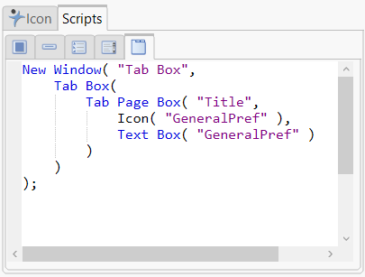

The Built-In JMP Icons add-in provides access to the names of all the Icons available to you as a JSL programmer. These icon names can be used in Icon Boxes, Button Boxes, Tree Nodes, List Boxes, Tab Page Boxes, add-in menu item icons, and can be set as window icons.
This add-in is mostly a re-write of the Icon Names Addin, developed by @JeremyFrancis and later updated by @pmroz.
Some improvements in this add-in:
To run the add-in, click Add-Ins > Built-In JMP Icons.
SAS and JMP reserve the right to change the icons and icon names at any time, without warning.
