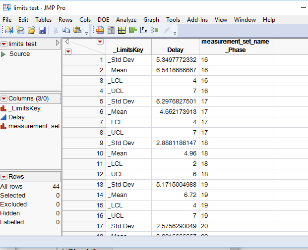

Here is a way that should work.  It involves using a saved limits table that contains phases, and creating a new column in your data table that has the same value as your Measurement_Set_Name.
In your raw data table, add in a new column by the name of
     measurement_set_name_phase
The reason for this, is that you need to have both a By value set and a Phase value set, and JMP will not allow the same variable to be used by both By and Phase.
Next create a limits table fashioned like the following:

Now go into your XBar Chart and set it up, specifying measurment_set_name as the By and measurement_set_name_phase and the Phase variable,
Then click on the "Read Limits" button.  It will open a folder for you to specify which jmp file to read in.  So above, when you are finished creating the limits table, you need to save it to a folder.

Thanks Jim for your fast answer then
I have create a phase from my table. can you show me how to transpose it similar like yours?
and we do not need _mean and _Std Dev right? I'm try to run the individual measurement chart

go to
     Tables==>Stack
and stack the 3 limits columns, and then change the new column called Label to _LimitsKey and the column called Data to Weight
