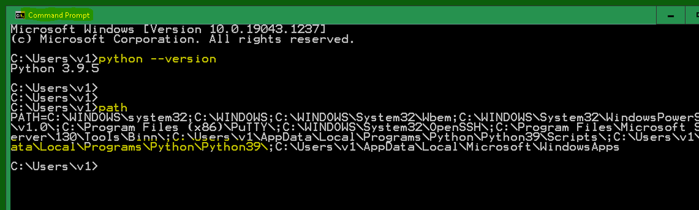

Not a Python expert, but...
  1. If you still have 15 installed, does it still work there?
  2. Does it run from the cmd.exe window? I used python --version and the path command to peek at my installation.
The path command shows two Python directories.The path command shows two Python directories.
I think JMP probably uses registry settings to find the python installation. There is also an argument in the PythonInit or PythonConnect to specify the path.
I do not use the anaconda version, and I do not use virtual environments.
