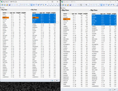

Does anyone know if there is an option in JMP Pro 17.2 to make the report from a data table highlight the same way as was done in JMP14?
Here is an image that shows JMP14 on the left, and JMP17 on the right -- selecting rows in the table on JMP17 obscures any cell coloring that the report had.
desired behavior from JMP14 (left) and incorrect behavior from JMP17 (right):
Here's the script I used:
Names Default To Here( 1 );
dt:NAME << Color Cells( "Orange", 3 );
jmp_report = New Window( "Big Class",
	<<show menu( 0 ),
	<<show toolbar( 0 ),
	Text Box( "Big Class" ),
	H List Box(
		Outline Box( "Big Class", dt << Get As Report ),
I hope I'm missing something, but I fear that it's just how JMP operates now.

txnelson
Re: JMP Report Table Cell Coloring
I have replicated your findings in JMP 14 and JMP `17.   JMP 18 has the same result as JMP 17.

ErraticAttack
Level VI
Thanks for checking on JMP18 -- I was wondering about it.  I need to see if I can request this feature in the next dot version of JMP18

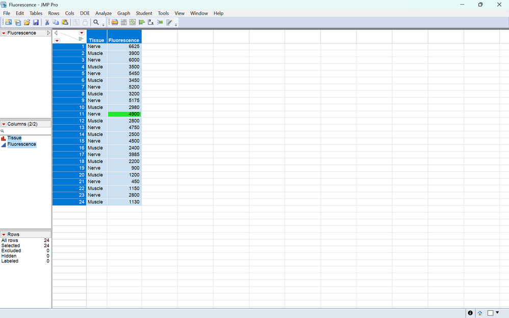

thiennguyen
Level III
I don't think it's a big problem. When I use JMP 17.2 and highlight a cell in my dataset, the color doesn't change according to my selection.
ErraticAttack
Level VI
You're using a data table box -- not a data table report.
