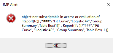

When I run the script I get the following:
Any thoughts?

txnelson
Re: Help with script to rename data table
My guess is that the Fit Curve is failing, and therefore, "fc" is not getting populated.  One item that could cause this is that either your X or Y columns are not set as Continuous.

ClusterFerret68
Level III
thanks Jim.
Both are continuous and the 4PL fit works if I do it independently.
Chris
txnelson
Remove the
fc << close window;
and then run the script again.  The error message is indicating the display output window can not be found.  If the window is closing faster than the Make Into Data Table, there could be an issue.
