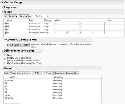

By default, for k levels of your discrete numeric factor, the assumed model by JMP may contain polynomial terms up to k-1 order (like in the screenshot taken, I have 4 levels in my X4 discrete numeric factor, so JMP has added in the model tab the terms X4*X4 and X4*X4*X4).
Note however that if you have strong differences between the intervals of your discrete numeric factor, this may affect the identification of statistically significant polynomial terms and the selection of an appropriate model, as it will be more difficult to find and fit a polynomial model if points are not homogeneously distributed.
